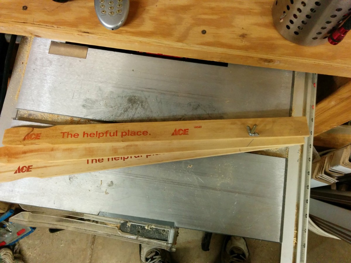

Three paint sticks held together on a pivot with a wing nut to tighten them, and pen lines drawn on them:
This is a makeshift tool, but what is it for? I know the answer but what's your guess?

Pantograph, angle finder, angle repeater, circle drawer...replacement peacock butt...poor man's nunchucks...???
None of those exactly, but some come close.

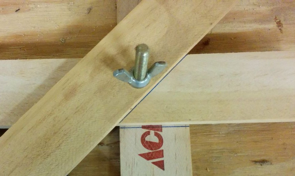

The wing nut adjustment is to allow the sticks to be lined up with the pen lines:

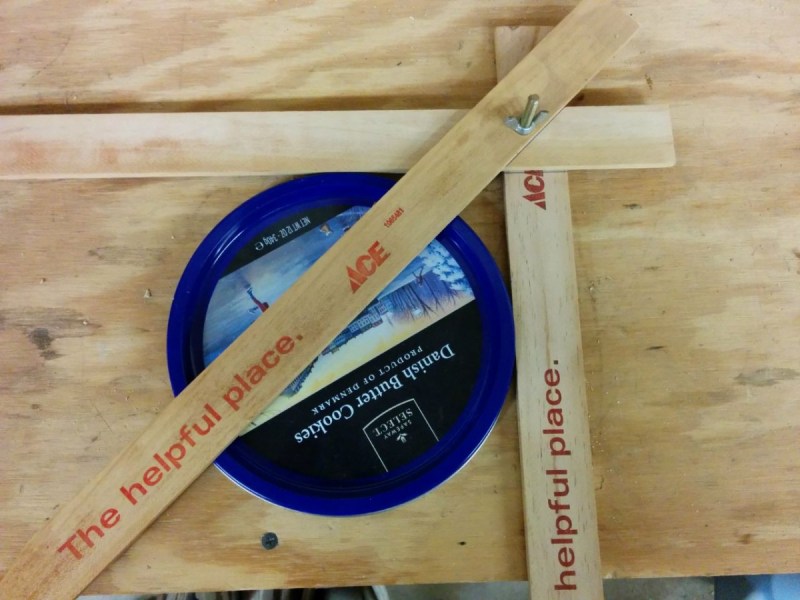

And then its function is obvious:
It's a center finder for circles.
I found this the other day tucked into a nook under my workbench.  Clearly I made it at some point, but I don't remember doing it, or why I needed it.  It took me a couple of minutes even to figure out what it was.

@dwasifar so you have two to find diameter so they can cross and find center point?
I sincerely hope you're joking. :)

I don't think I was joking far as I know haha but you mentioned finding the center. I was thinking center as in center point.

Yes, that's what it's for.  You draw a line, rotate the tool (or the piece), and draw another.  Where they cross is the center.  No need for two tools.
