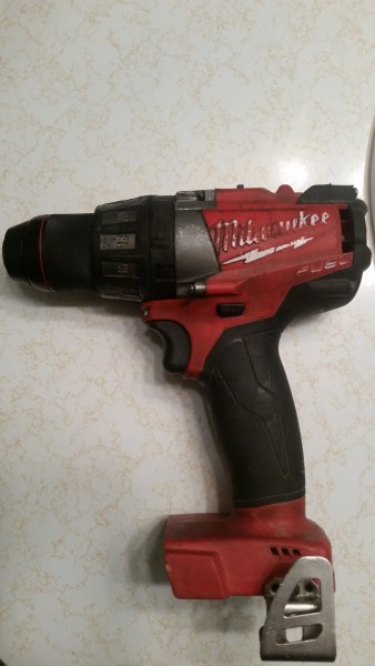

Biggie Posted March 5, 2019 Report Share Posted March 5, 2019 I hope to have better luck with the new style chuck. This drill has been a money pit and I probably should have just taken the money I paid for the new chuck and bought another gen 3. I personally have found that it's worth spending the extra money for the hammer drill(2704,2804) vs the drill drill/driver(2703,2803). Even though I don't use the hammer function, the hammer drill comes with a chuck with carbide inserts and without them I wear out the chuck jaws. So the replacement chuck I bought for my 2703 is the new 2804 chuck. When you look these up on parts web sites they don't say they're compatible but they are. 1 Quote Link to comment Share on other sites More sharing options...

Biggie Posted March 8, 2019 Author Report Share Posted March 8, 2019 Yea it's always a hard decision when to fix and when to move on. Dumb thing with my 2703 is its only 2 years old. When it was 1 year old the rotor went bad. I sent it into a service center instead of e-service and was denied, last time I'll do that. Now it's 2 years old and I replaced the chuck. Total it's only $60 I have into it but I've seen new 2804 for as low as $80 on ebay. My thought process was that I have a 2703 and 2704 so between the two of them I figured I could get some use out a newer "better?" chuck. Quote Link to comment Share on other sites More sharing options...
