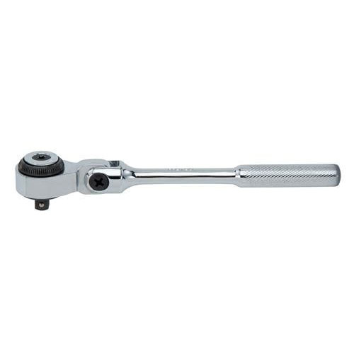

Here is the updated 4757 I'm getting instead of the original posted model
After a month on back order the J4757F came today. Very happy with it on initial impression. What appears to be a thumb wheel is simply for reversing directions and the Torx screw merely holds the ratchet together. Very smooth operation. The flex head does not have positive stop capability. I guess it's a matter of preference. It doesn't bother me at all on a ¼" model but I don't think I'd care for a ⅜" or ½" without a positive stop function on the head.
