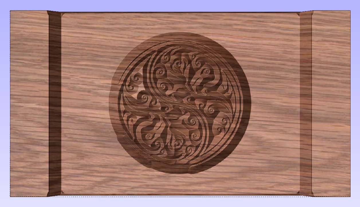

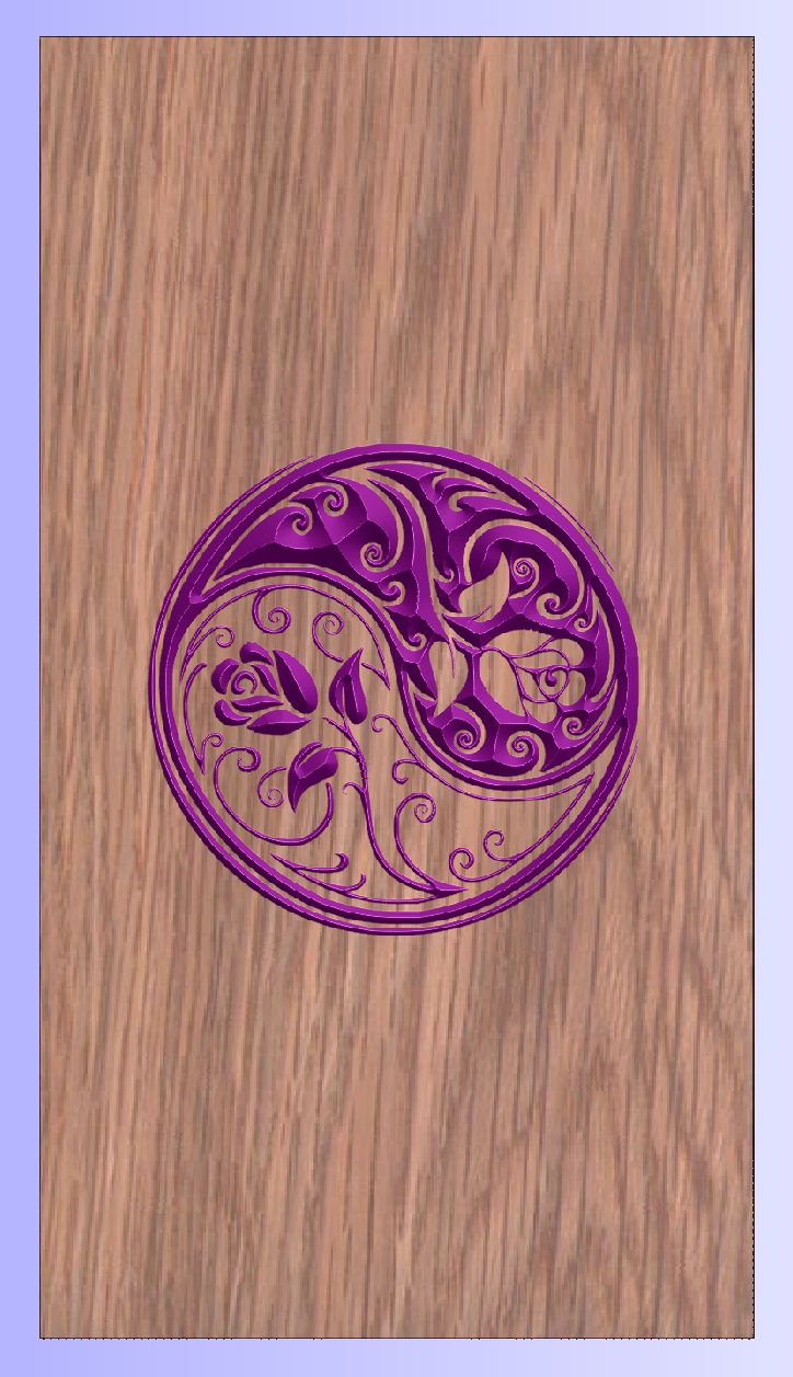

The process is V-Inlay. Essentially you cut a pocket with beveled walls. The purple represents the area that is routed. I chose Purple because I wanted to get an idea what it would look like with the purple heart wood inlay
and then cut the 'male' inlay with inverted bevel walls. The two pieces fit together and form a nice clean fit. ... hopefully.

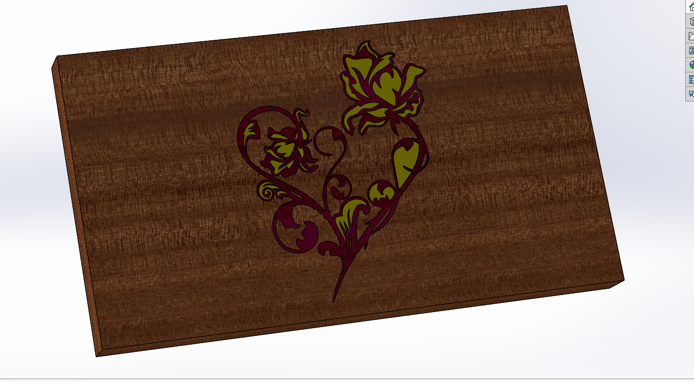

As far as the design, I was going to do a double inlay, purple heart and yellow heart. Using solidworks I designed the inlays and pocket.

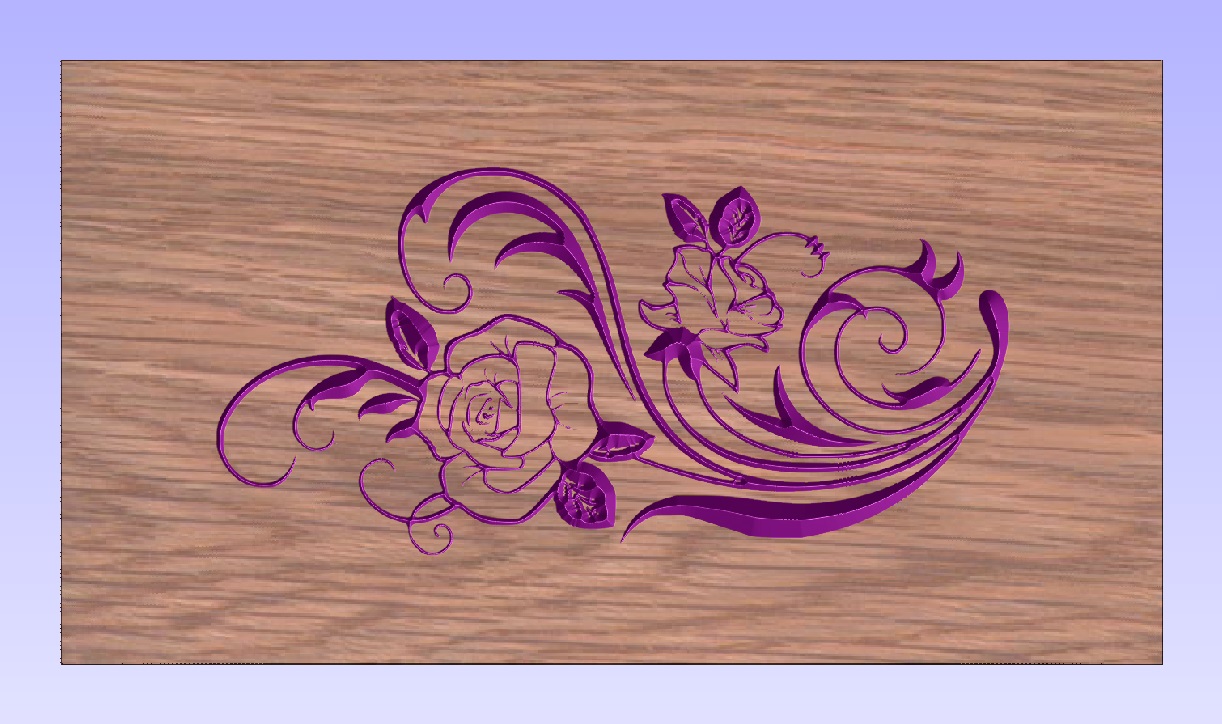

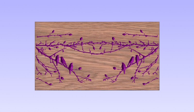

That method became too complicated for my first go so I decided to simplify things and use Vcarve software with only one inlay. I'll get fancy later. Now to decide on what to carve.
here are a few designs I threw together. (No TIA logo for the Wife.. sorry guys)
I can convert just about any simple-ish line drawing into an inlay, so if you have any ideas pass them along. Im not very artistic.

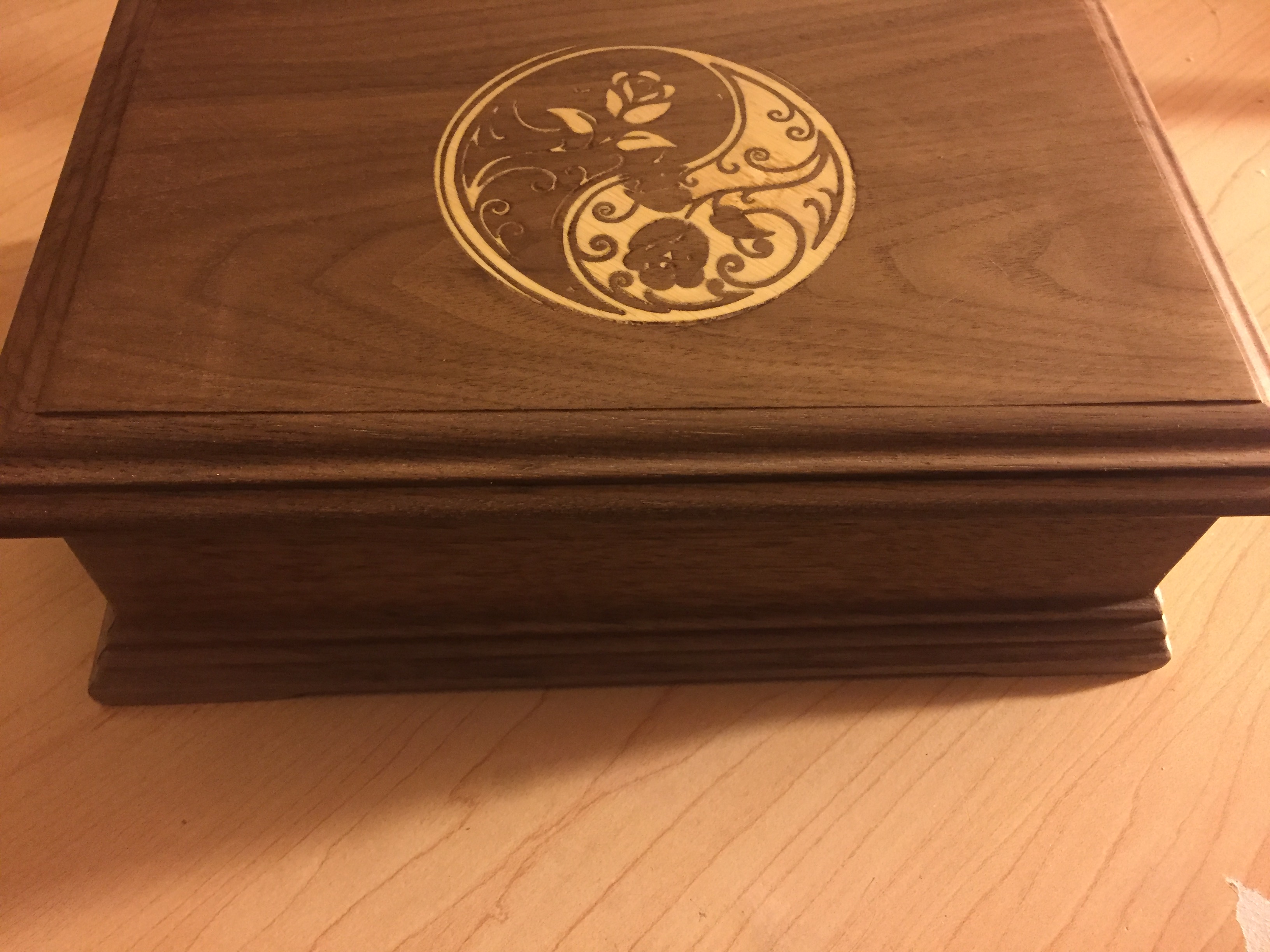

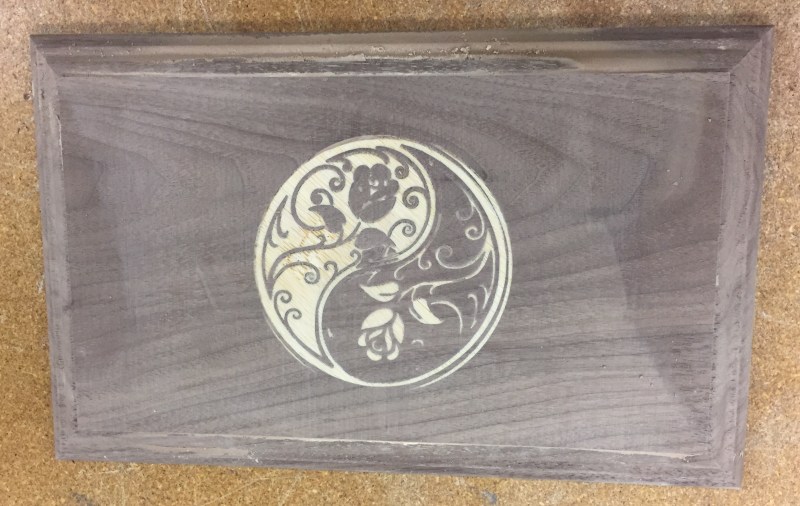

I worked till about 3am. Although I'm not finished, it's in good enough shape to give her.
I used a little pastwax to bring out the natural beauty of the wood. I'll use oil later and give this box a proper finish.
Inside is lined with felt & includs a Rockler music ? movement.
I would like to add miter splines and  more engraving also.
I made a video explaining the inlay concept & I'll upload later. My wife gets alerts from my YouTube uploads & she hasn't opened it yet.

Well, the box isn't perfect but my wife loved it anyway, I've learned a lot from this build and look forward to trying again.
I will apply a proper finish and try to fix some of the 'mistakes'. Here's a short video of the build process. I've got better 4k footage but need to spend time in the editing room.
