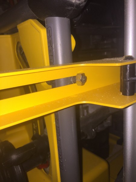

denrusso Posted November 13, 2017 Report Share Posted November 13, 2017 I've seen a few videos on youtube that show the DCS7485 mounted on a DW7440RS. I thought it would be an easy fit and so ordered the stand. Unfortunately, it seems that some modification is necessary to mount this saw to this particular stand. Has anyone here done this? If so, can you share what you did to make it fit? Thanks, dr Quote Link to comment Share on other sites More sharing options...
dilloncorr Posted November 13, 2017 Report Share Posted November 13, 2017 So it’s not too bad to retrofit. The holes in the base of the stand are BARELY too small. Almost makes me wonder if someone forgot a “fudge factor” and the thickness of the powder coating. The bigger problem was that the base on the saw has angled holes but the stand is built for vertical bolting. Get rid of some washers (who needs those anyway, amiright?!) and the stock bolts fit. Torqued the hell out of them and good to go! 2 Quote Link to comment Share on other sites More sharing options...
Roasty Posted November 13, 2017 Report Share Posted November 13, 2017 I bolted mine through the rubber feet. Wider stance and all that and bolts are straight through no angled business. Quote Link to comment Share on other sites More sharing options...
denrusso Posted November 13, 2017 Author Report Share Posted November 13, 2017 3 hours ago, Roasty said: I bolted mine through the rubber feet. Wider stance and all that and bolts are straight through no angled business. I'm leaning towards this method. I tried to get one of the supplied bolts into the predrilled holes and the saw and by the time I was done the threads on the bolt were all chewed up. What size drill bit/bolts did you use? Thanks, dr Quote Link to comment Share on other sites More sharing options...
Roasty Posted November 14, 2017 Report Share Posted November 14, 2017 Think I went with m8 bolts, and use a pilot bit to get your hole centre first. Quote Link to comment Share on other sites More sharing options...
Framer joe Posted November 15, 2017 Report Share Posted November 15, 2017 I have the same set up, love that stand ...it’s bolted at an angle with longer bolts...no problems yet, in and out of the truck every weekend.... looks good nice job ! Quote Link to comment Share on other sites More sharing options...
