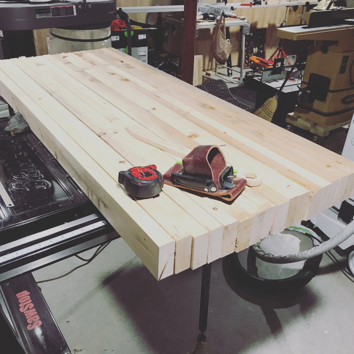

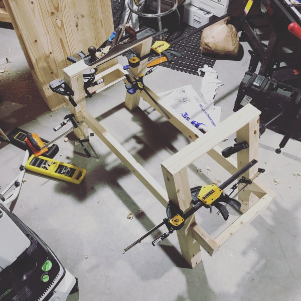

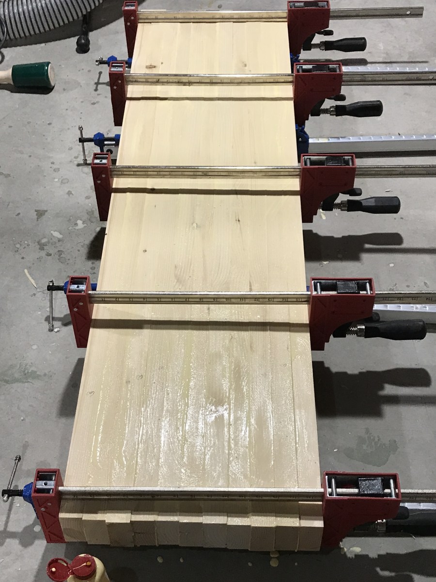

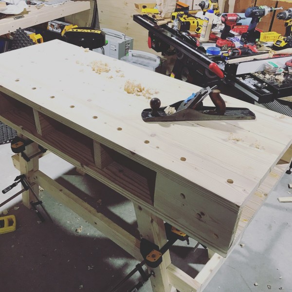

ChrisK Posted December 12, 2018 Report Share Posted December 12, 2018 1 hour ago, Teyayaje said: I would like to build a new workbench. My current one I got for free on Craigslist and has gotten the job done but lacks a lot. I'm looking into using a solid wooden door as the top. I'm finding several sources for used doors but they are composite cores. They are very heavy and seem very solid but should I hold out for solid wood like oak instead of a composite type? Thanks What are you using the bench for? Are you a wood woodworker using hand tools and or power tools? Solid core doors are are a great option for a top with an added surface. I just completed one of two woodworking benches in my shop, one of for multiple types of woodworking tools versus my still uncompleted bench. In both cases I opted to make both benches from our typical white pine soft wood, both tops different but the same in basic structure...laminated face to face after milled and surfaced flat. If you are looking for a general purpose bench for machine work, household chores and diy projects, I think a basic plywood bench would suffice. I had one in my last shop in my old shop that though had limitations was quite solid. I used that bench for woodworking projects as opposed to machine work (they are called....mechanics. Of which I am not) or general diy jobs. I completed more than a few cabinet and small projects with it. Biggest problems I had with my old bench? Lateral movement and lack of clamping space. Welcome me to the forums and Merry Christmas. 2 Quote Link to comment Share on other sites More sharing options...

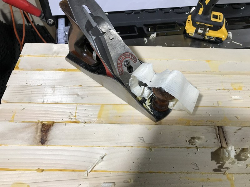

regopit Posted December 16, 2018 Report Share Posted December 16, 2018 Hand planing to flatten the top. I like you ambition. 🏆 2 Quote Link to comment Share on other sites More sharing options...
