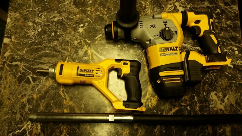

Biggie Posted January 25, 2019 Author Report Share Posted January 25, 2019 Well I guess we're going to try the dch293. If I still need a sds max I can always get one later but I know either way this will see plenty of use. Also picked up a concrete vibrator. 1 Quote Link to comment Share on other sites More sharing options...

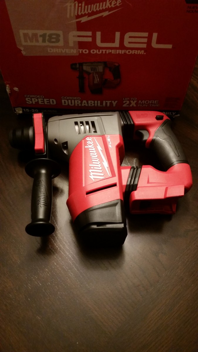

Biggie Posted March 3, 2019 Author Report Share Posted March 3, 2019 Well since no one could really give me a direct comparison between the dewalt and milwaukee 1 1/8" I ended up with both haha. I really still wanted a bigger m18 on my truck and the price was just too good to pass up. Now if winter would go away so we could get back to real work and test them out. Quote Link to comment Share on other sites More sharing options...
