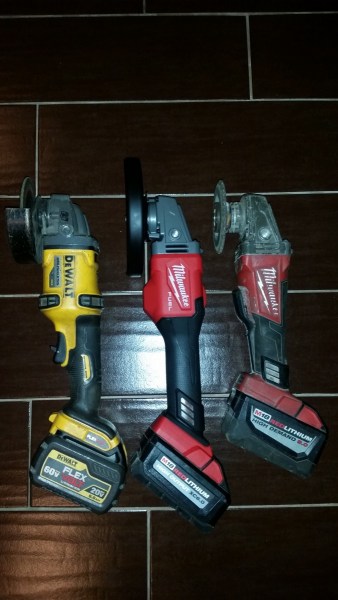

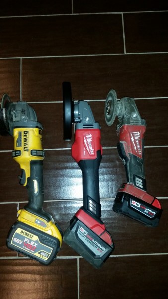

I got my grinder today and while I haven't had a chance to actually use it I thought I would post some first thought.
It only comes with a 6" guard and I plan on primarily using a 4.5" blade.  The dewalt 60v came with both a 4.5" and 6".  It's also my first milwaukee grinder with the new style guard, which being a dumb person that takes the guard off sometimes I don't really care for the design.
The grinder is very similar in size to the 60v but the handle doesn't feel as ergonomic and you can't grip as close to the head of the grinder.  I don't mind the wider grip on the smaller m18 2780-20 4.5" grinder because it allows you to grip closer to the head but on the new 6" it feels like they should have slimmed down the handle.
I'll report more after I get a chance to use it. Here are some side by side size comparisons.
20190529_211031.thumb.jpg.3a4424e3322895de2a5e791bcd509b66.jpg20190529_211236.thumb.jpg.c548bd70a67fecc118ffd1a76e90fadf.jpg
2.0/6.0ah on the 60v, 6.0ah HO on the m18 6", and 9.0ah HD on the m18 4.5"
3.0/9.0ah on the 60v, 9.0ah HD on the m18 6", and 4.0ah on the m18 4.5".
Definitely curious to see what you think about the new grinder power and battery life wise. We have 3 of the 4.5" version and like them a lot but can always use more power. Disappointing they have such a long handle on the newer one. Thanks for the pictures so far! Will be watching this.

Yea I was a little disappointed at just how big it is.  I was thinking it was going to be closer in size to the 4.5" version with just a bump in power.  I don't know what they have inside the handle area but it feels like it should either be shorter or thinner.  It kind of handles like a rat tail grinder and it's like they really have it set up to be used with a side handle.
I just did a little cleaning up on the welding table grinding some test welds but I would say it's on par with the power of the dewalt 60v.  If you're not familiar with the 60v power, it truly feels like a corded 4.5" grinder.  I still can't comment on run time.  While the extra power is nice in some situations and it'll have its place on my truck,  I think the smaller 4.5" version will still be my go to.
