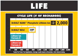

Bingobelle Posted January 30, 2011 Report Share Posted January 30, 2011 You are talking about DC9180 and DC9181. But on my batteries it says DE9180. What is the diferent. I´ve the nano symbol and it was advertised to be able to recharge 2000 times. Maybee it is written DE on batteries sold in europe and DC on batteries sold in the states. I bought my machine in Sweden. And how much performance is expected to be left after 2000 cycles? !00 percent or maybee just 50 percent. Or is it going to downgrade after 2000 cycles? Quote Link to comment Share on other sites More sharing options...
Madtec Posted January 30, 2011 Author Report Share Posted January 30, 2011 You are talking about DC9180 and DC9181. DC9180, the compact battery (DC9181) do not have that particular software But on my batteries it says DE9180. What is the diferent. I´ve the nano symbol and it was advertised to be able to recharge 2000 times. The DC/DE9180 batteries with yellow side labels have the fade software Maybee it is written DE on batteries sold in europe and DC on batteries sold in the states. I bought my machine in Sweden. Yes, there is no difference, just the labels And how much performance is expected to be left after 2000 cycles? !00 percent or maybee just 50 percent. Or is it going to downgrade after 2000 cycles? The 2000 charge cycles is a cell manufacture spec if i am not mistaken, so use the battery for what it's intended purpose is. Quote Link to comment Share on other sites More sharing options...
Bingobelle Posted February 2, 2011 Report Share Posted February 2, 2011 One more interesting thing that I do not think anyone have asked before about. Dewalt and makita just to name a few claims their li-ion battery will charge upp to 2000 cycles. But what is really a cycle? They say no memory effect so you can charge them when ever you like to. That´s fine but if you for example charge your battery 10 times and thay are only drained for example 1/3 of a full charge. Will this shorten the battery 10 charges of it cycle life or only 3 charges? Personaly I only charge them when the battery is empty, do not se any point to put the battery on the charger after a couples of holes drilled. But I think you can see my point. If you have a habit to put the battery on the charger very often ( because no memory effect ) when not needed to, will you be able to have the whole RUNTIME from your batteries? Quote Link to comment Share on other sites More sharing options...
