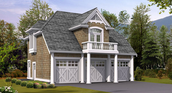

If it was up to me this is what I would build to spend the rest of my days in. 3 car garage with a 1 bedroom apartment above it. But we are moving to the beach and the wife wants to have room for when the kids come to visit. Maybe if I double the size to 6 cars and 3 bedrooms she would go for it. One can only wish.
