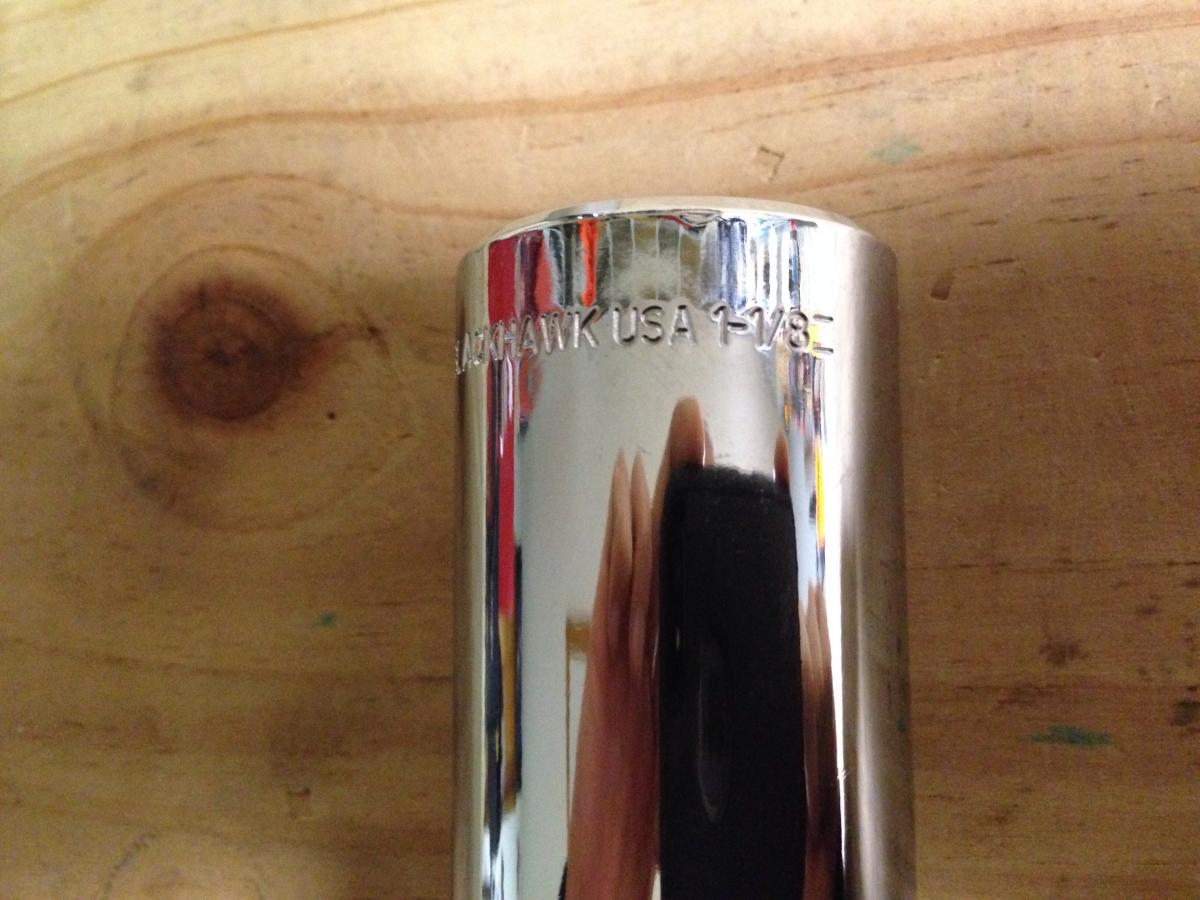

Here you can see the smaller stamping of the Blackhawk

To summarize, both brands are very good quality and if you can live with the smaller stampings, the Blackhawks are very good quality, full featured, USA made, and very affordable. You know me, I don't fool with sub-standard tools, and I have no reservations at all about recommending Blackhawk sockets or wrenches for professional use. They are the best value in sockets IMO.
Thank you, sir! It looks as if the Blackhawks are stamped with a smaller number, but deeper, correct? The Protos don't look to be stamped very deeply...
You are correct...kinda. Blackhawks are stamped, Proto's are engraved on the bigger sizes and stamped on the smaller. The ones that are stamped are stamped bigger than the Blackhawks.
