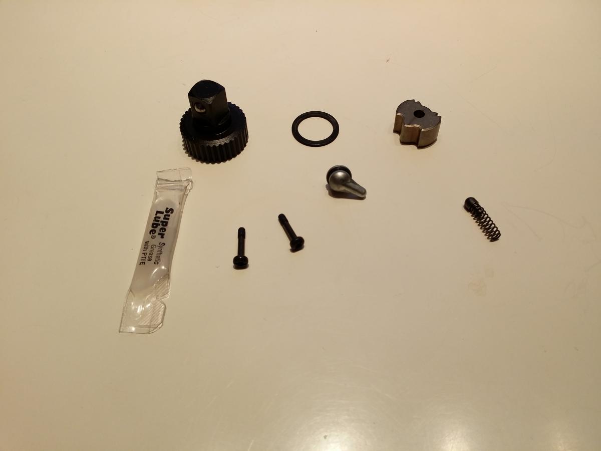

NERemodeling Posted November 21, 2014 Author Report Posted November 21, 2014 So I opened it up and the loosen teeth on the pawl were sheared right off!Then I made the mistake of disassembling it further, haha. There is a little ball bearing and spring that need to be fully depressed into the head before the pawl can be reinserted.. not proving to be an easy task without some sort of specific tool to hold the bearing and spring in place. I just reassembled it without the bearing in place, taped the bearing to the handle and am going to send it off to snap-on to deal with!
NERemodeling Posted November 21, 2014 Author Report Posted November 21, 2014 In that first picture it actually looks like the teeth are intact.. it's just that very front edge where they must not contact the gear.. everything being that is gone!

NERemodeling Posted November 30, 2014 Author Report Posted November 30, 2014 Thank you all for your advice and help, here's an update:I emailed snap-on, they immediately said they would send out a repair kit. Then I responded asking about the spp744, that's when things got annoying... a different rep responded to my reply and didn't understand why I wanted the spp744, so I explained, then a 3rd rep responded to my explanation, she agreed to send me the spp744, then I thanked her, then a 4th rep responded to my thank you and said they wouldn't send the tool, haha, so I just left it at that, then a 5th rep email me saying things would be sent to me, not clear what.. why couldn't I just communicate to one person?? Makes it frustrating to try to explain your situation to 5 different peopleI got the parts in the mail a few days later but no spp744.. it didn't actually matter, they improved the spring/ball design, it's much more user friendly now. I still had to use something to depress it into the hole in the head but didn't heed the speciality tool.Repair only took a few minutes.. first pic is the old parts, second is the new parts (the ball and spring are now more like one piece, it's not a ball anymore but a weird cylinder shape with a rounded top and bottom peg that fits into the spring) third pic is the part number and what it fits in case anyone else needs one.
