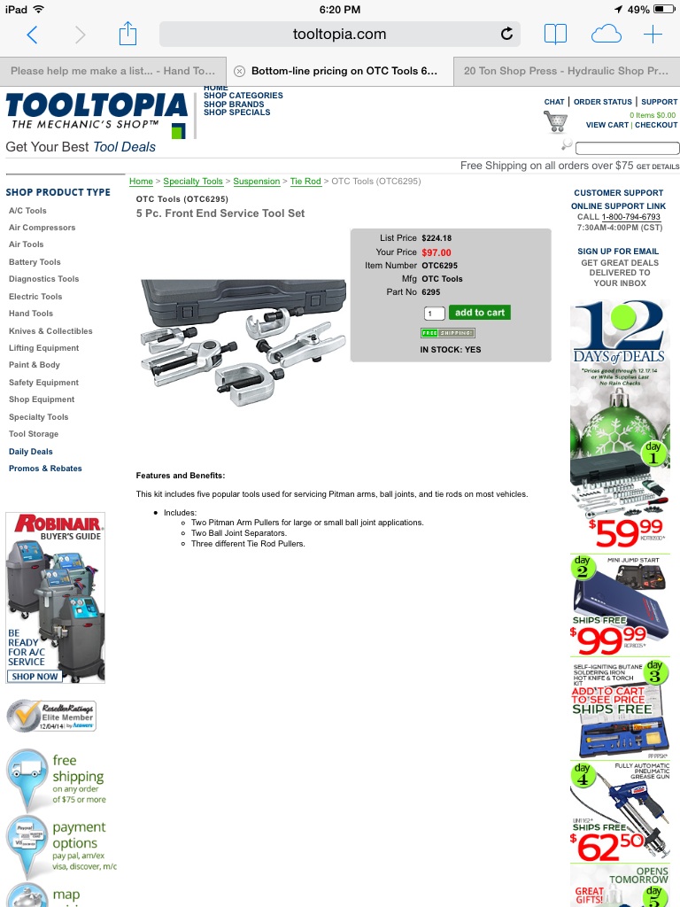

Mikevango Posted December 4, 2014 Report Posted December 4, 2014 These will help you do front end work.
