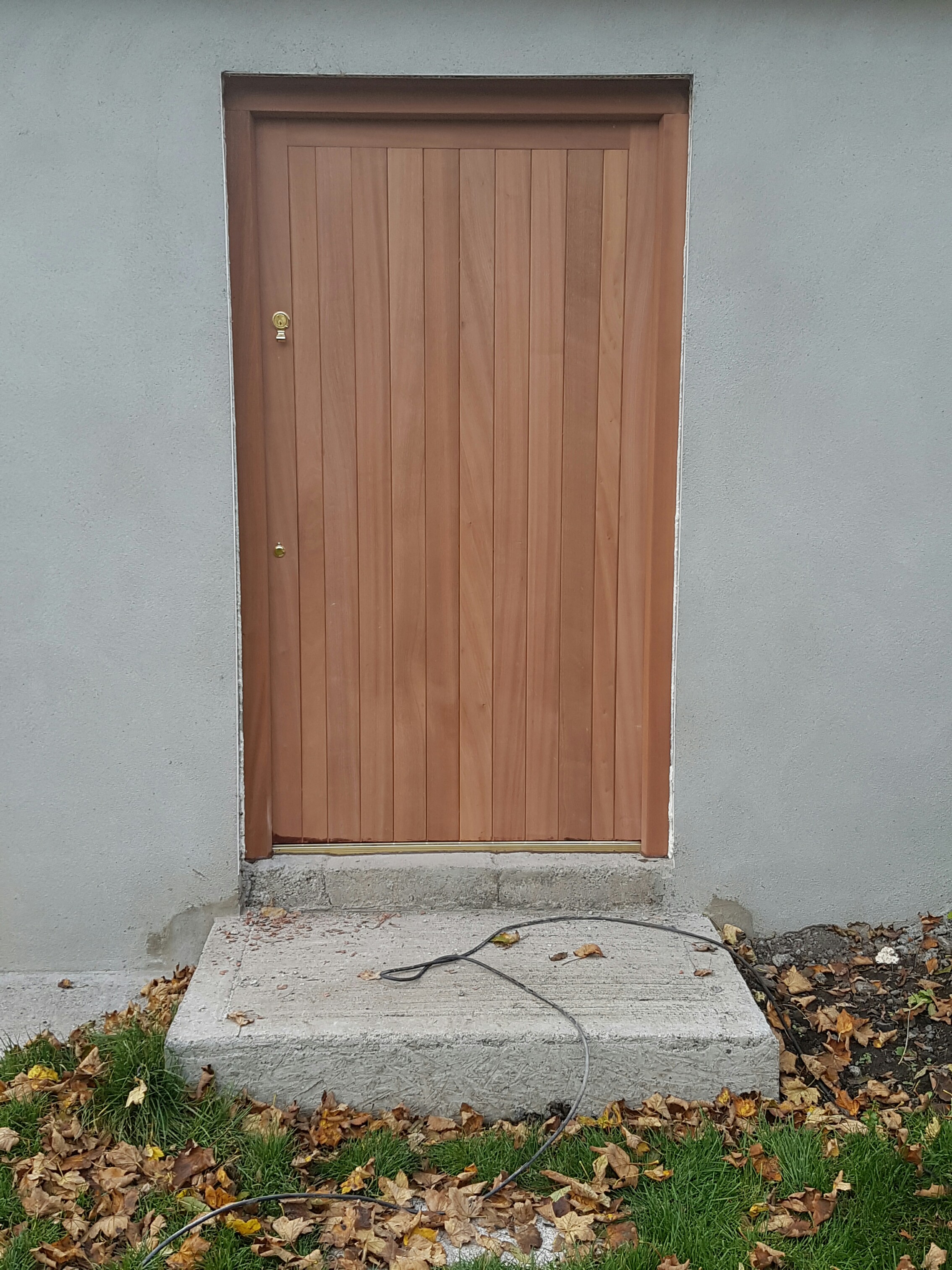

Turner85 Posted November 19, 2016 Report Share Posted November 19, 2016 Good to know this. I just put up a mahogany door today which I found really soft on the tools. It must be the African mahogany on the chart 2 Quote Link to comment Share on other sites More sharing options...
