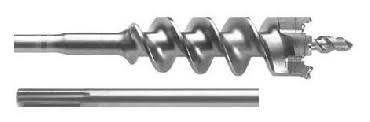

Bingobelle Posted June 20, 2011 Author Report Posted June 20, 2011 I ordered the machine today and hopefully it will come in the end of the week. I read the review you linked to and actually I found one more and also in that one they where 100% satisfied with the machine. So with you it is 3 different reviews that gave the machine full "pott". I´m sure I will be very pleased with the tool. I also read that the hammer are able to make up to 65 mm big hole with something called "break through drill" ( translated from the swedish word ) Must admitt that even though I have been working for 15 years as a electrician I have never seen or heard about that kind of drillbit. I guess that kind of drill take less stress on the machine and therefore it is possible to make bigger holes. I also guess that that kind of drill bit is slower and more expensive compare to a "traditionall" hammer drill bit. Thanks for telling me your experience with the tool. Regards
kanxrus Posted June 20, 2011 Report Posted June 20, 2011 Interesting.... I've never heard of that either. Googled it; Looks pretty wild!
Mr. Yellow Posted June 20, 2011 Report Posted June 20, 2011 DeWALT sells those in Europe too. For use with SDS-Max hammers. For drilling holes in concrete and masonry with a thickness up to 550mm. DT6790 (55mm) catalogue price € 351,90 DT6791 (65mm) catalogue price € 404,70 DT6792 (80mm) catalogue price € 461,90 Definitely not the cheapest drills
