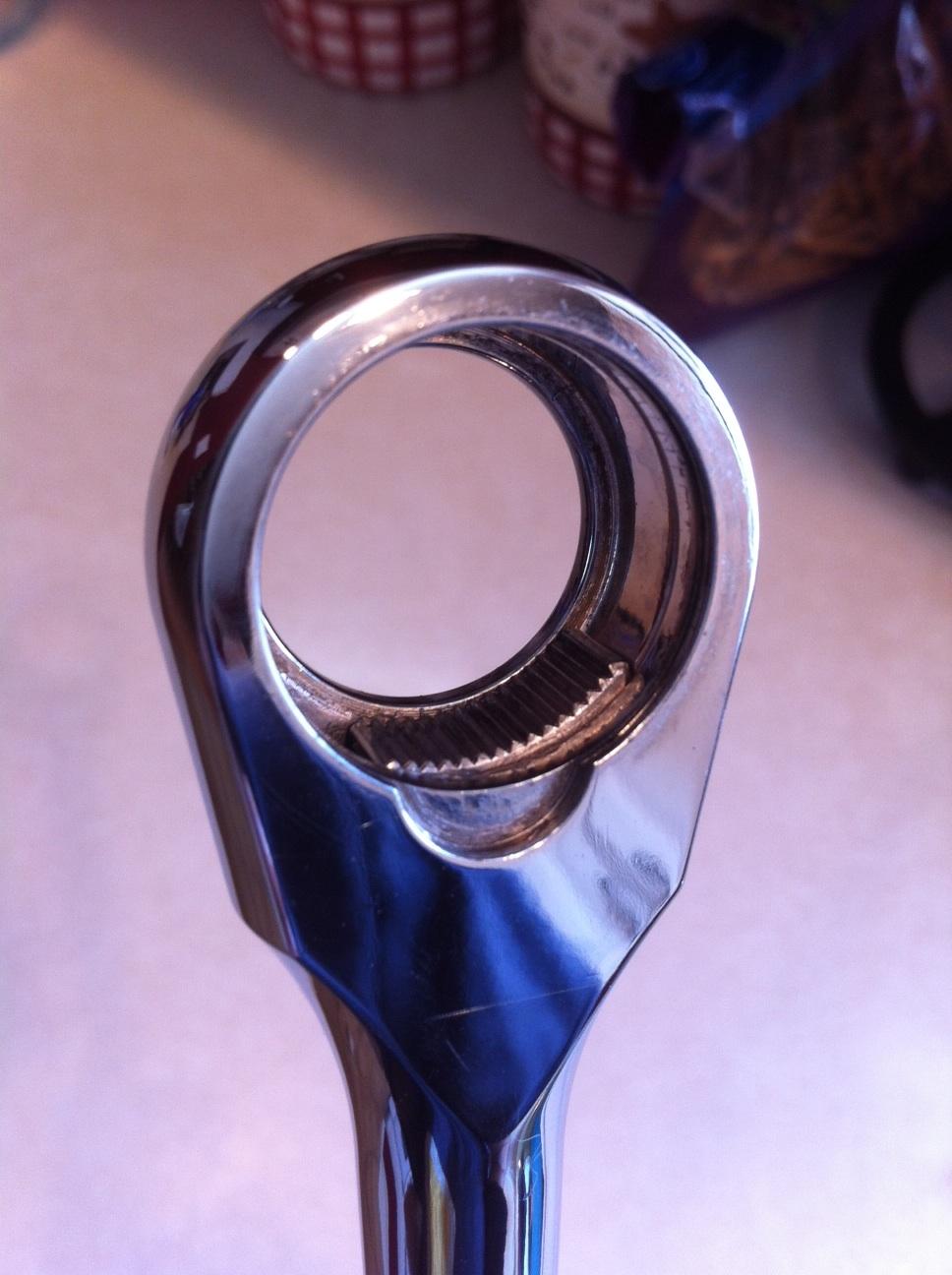

Well, after a week of using them I'm happy to report these ratchets work as good as they look. The 1/2" was a little stiff out of the box, but after applying a little Red Lube of Love it improved. They're 72 tooth, single pawl, and best I can tell they're getting 10-12 tooth engagement. These are stout rats. I'll definitely be ordering the 1/4" model. I've really grown fond of Blackhawk here lately. They are excellent tools for the money.

The Blackhawk, while not as smooth as the Kobalt, has more teeth engaged at once which will undoubtedly make it a bit stouter. The Blackhawk has a smaller head as well, making it a bit easier to get into tight spots.

A very light coat of "Red Lube of Love" will quiet them down. I took mine apart, lubed the gear wheel and the pawls, and once I got it back together I noticed it was a little harder to turn than before. I took it back apart, wiped out the excess, and now it works like a dream. I try to service all my ratchets at least twice a year.
