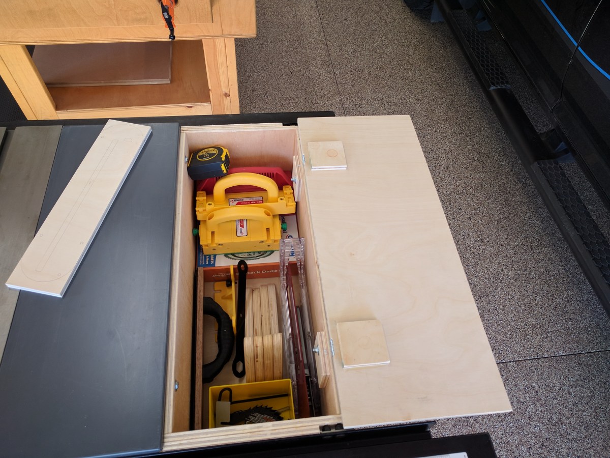

sadfkjnbb Posted September 28, 2017 Report Share Posted September 28, 2017 3 minutes ago, rrich1 said: Well I stand corrected. I'm not the only one. Something to note is the plate is so thin I didn't want to mess with making one for a dado stack or zero clearance. I bought the delta dado throat plate off Amazon. Put it in your cart and wait for the price to drop. I think I got it for $10 cheaper than normal price. Sent from my Pixel XL using Tapatalk I just got done making a storage box mounted on the side for mine (thanks for the idea!) and am about to tackle making a zero clearance plate next. The way the plate sits in the table its gonna be iffy making it work since there really isn't a lip all the way around to hold the plate up but I'm gonna give it a whirl. 3 Quote Link to comment Share on other sites More sharing options...
rrich1 Posted September 28, 2017 Report Share Posted September 28, 2017 I just got done making a storage box mounted on the side for mine (thanks for the idea!) and am about to tackle making a zero clearance plate next. The way the plate sits in the table its gonna be iffy making it work since there really isn't a lip all the way around to hold the plate up but I'm gonna give it a whirl. you're welcome. How do you like it so far? Pics of the box! Sent from my Pixel XL using Tapatalk 1 Quote Link to comment Share on other sites More sharing options...
sadfkjnbb Posted September 30, 2017 Report Share Posted September 30, 2017 I love it. I usually wheel the saw to the driveway and now I have everything with me instead of making repeated trips to grab something. 2 Quote Link to comment Share on other sites More sharing options...
rrich1 Posted September 30, 2017 Report Share Posted September 30, 2017 I love it. I usually wheel the saw to the driveway and now I have everything with me instead of making repeated trips to grab something.Looks great. You took a different approach than I did. Good job. Sent from my Pixel XL using Tapatalk Quote Link to comment Share on other sites More sharing options...
