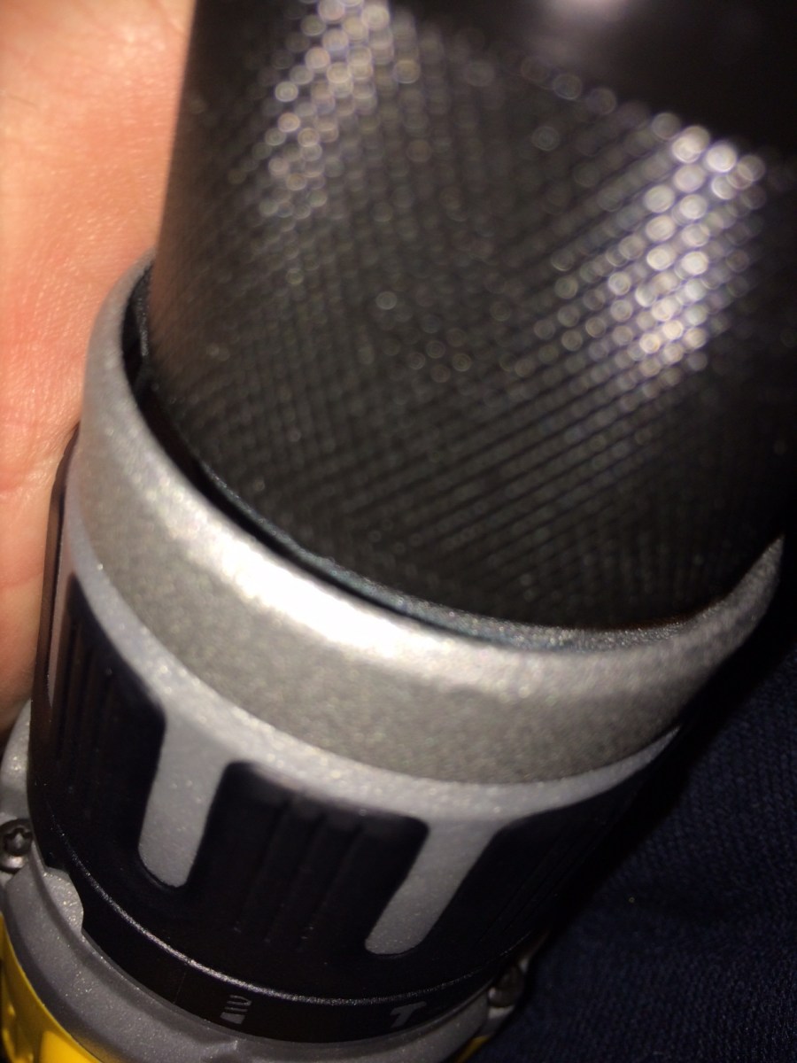

I got a different chuck
As per photo.
Drill is purchased in New Zealand though.
Mines got some miles on it lol maybe I can't see the whole thing, but that sleeve looks exactly like my baby's did, back before some apprentices and tight spots got to her lol. I agree though, pull it to be sure. DeWalt metal- Rohm, plastic-jacobs has been my understanding for a long time as well. Can't imagine they change components like that geographically without some crazy back story.
