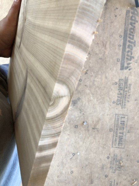

I'm curious if they ever upgraded the detent plate on the new saws that seemed to have been made out of aluminum so every time the table was locked into a detent they kept getting wider and wider until there was so much side to side play that you couldn't tell what angle you were actually set at. Also with the table working smooth for the first 3 days it was fine until it would get so hard to move that the table would slam into the detents making them wider.
I've used the corded 10" verson and the rails are super smooth, it was nice that it could be setup against a wall and the dust collection was good but everything else was a huge letdown. The blade not being in line with the rails was a pain when trying to make any adjustments to your cuts. If you wanted to take a hair off one part of a board and using the side of the blade to line up your cut it wouldn't work because the blade was already showing that it was off  right after making a square cut
