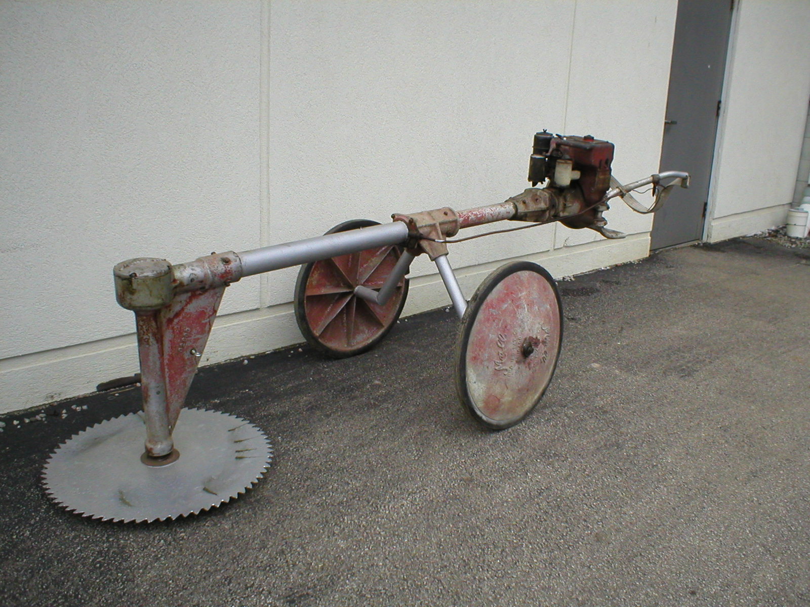

optimistspencer Posted November 5, 2015 Report Posted November 5, 2015 Ok so first thoughts. I would need:125cm disc. Anti kick back feature and low vibration features.Variable speed would be appreciable too. Need to be able to have several handle positions too. Need to try the paddle switch to find out whether I would like it. As for brands, I'd rather stick to ( not in any particular order) Metabo, Bosch, Fein, Flex.Lol, 125cm disk? XDSent from my One M8 using Tapatalk
hemdale Posted November 5, 2015 Author Report Posted November 5, 2015 Ahahha yes....sorry. But actually...
