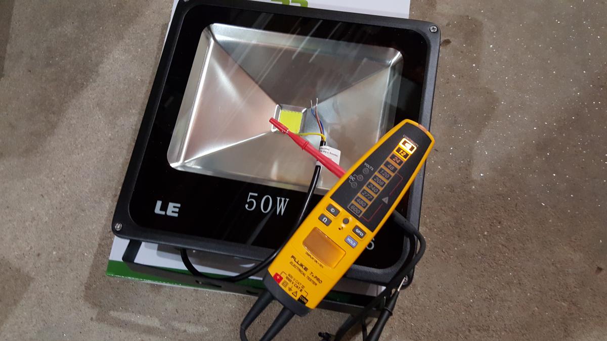

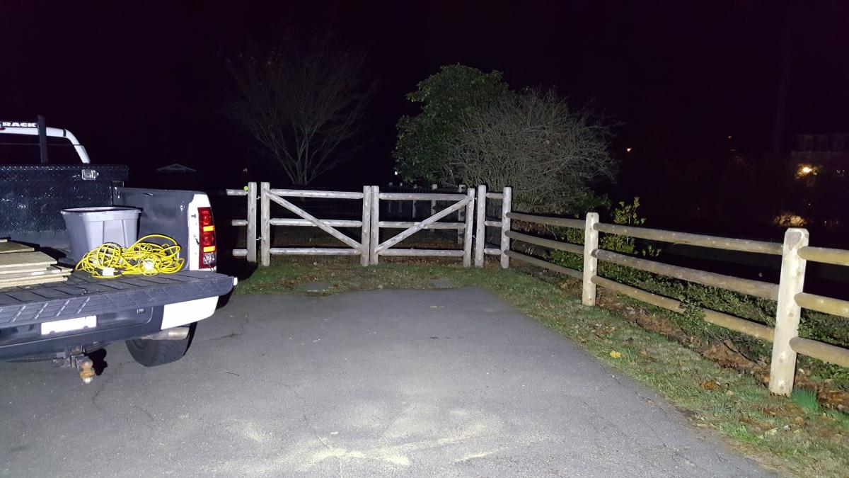

NERemodeling Posted November 16, 2015 Author Report Posted November 16, 2015 I got the 2 of them in Saturday and had a minute today to mess with them. I have to say, so far I am very very happy with the purchase.. The ground wire is indeed connected on bothThey are insanely bright. Haven't measured the watts yet but honestly I don't know if I will. They are plenty bright for what I need. 1
Poisonfangs85 Posted November 16, 2015 Report Posted November 16, 2015 Wow! Those are a lot better than I expected.
NERemodeling Posted November 17, 2015 Author Report Posted November 17, 2015 Seriously. I am very pleased. I don't really know if the pictures do them full justice. They are crazy bright in person 1
