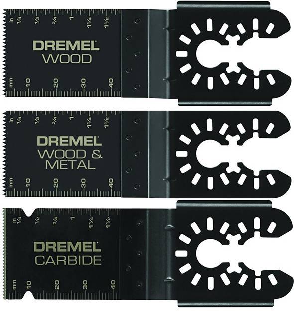

Found some Dremel branded carbide blades today with two mounting slots, one for the narrower more common style and another for Dewalt/Porter Cable.
From what I can determine though, the Dremel blades are made in China while the Bosch are Swiss.
