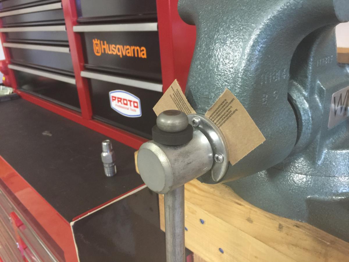

Conductor562 Posted October 22, 2015 Report Share Posted October 22, 2015 Wait until you remove the lead screw from the dynamic jaw. There's probably a bunch of those chips.Remove the 3 Phillips screws around the horseshoe collar on the nose of the vise. Once you remove the collar you can turn the lead screw out of the dynamic jaw. This should be all the disassembly you need to do.You don't need to do a full tear down for cleaning. Just wipe all the grease and chips out of the threads on the lead screw, re-lube, and re-assemble. IMPORTANT: When re-installing the horseshoe collar do not run the Phillips screws all the way back in. you need to make sure it has a proper amount of play. When the jaw is ran in you should be able to wiggle it just a bit. It's only under load when opening the jaw. Use a good business card or matchbook cover to set your gap like so:Also, remember to use blue locktite (removable) on these screw and the hex jaw screws any time you are re-installing them. There are lots of videos on YouTube dealing with Wilton disassembly. Half are from people who have no idea what they're doing, but it will give you an idea and you can adapt your method accordingly. Also, if you ever need to remove the butt cap, do not beat it out with a drift punch like most of these YouTube morons. Simply remove the lead screw from the dynamic jaw, them run it in the static jaw by itself to pop the cap out. If your careful, it won't damage the cap at all. Wilton still makes the best vises available. Yost USA vises are great vises too, but the don't have that Wilton sex appeal. 1 Quote Link to comment Share on other sites More sharing options...
Conductor562 Posted October 22, 2015 Report Share Posted October 22, 2015 And yes, I'd file that nub off the lead screw. My tool OCD would'nt let me sleep knowing that thing was there.Neither the nub nor the chips are going to impact performance or longevity, but it's pure laziness. How long does it take to blow chips out and grind the end of the lead screw?The Tradesmen are the exact same iron as the more expensive Wilton's at half the price. Quality control is the obvious difference. Even so, you'd think an extra 30 seconds of manufacturing would be feasible on a $500 vise. 1 Quote Link to comment Share on other sites More sharing options...

stainlessstroker95 Posted October 23, 2015 Author Report Share Posted October 23, 2015 Thanks for the help guys. I will take it apart further when I get some garage time in. Thanks for the pic of the gap. I seen an old timer do that trick with a match box and a coil on a lawn mower one time. Learned something new that do. And I agree, these vises are sexy. Quote Link to comment Share on other sites More sharing options...
redmed Posted October 24, 2015 Report Share Posted October 24, 2015 IMPORTANT: When re-installing the horseshoe collar do not run the Phillips screws all the way back in. you need to make sure it has a proper amount of play. When the jaw is ran in you should be able to wiggle it just a bit. It's only under load when opening the jaw. Use a good business card or matchbook cover to set your gap like so: Good to know! Quote Link to comment Share on other sites More sharing options...
