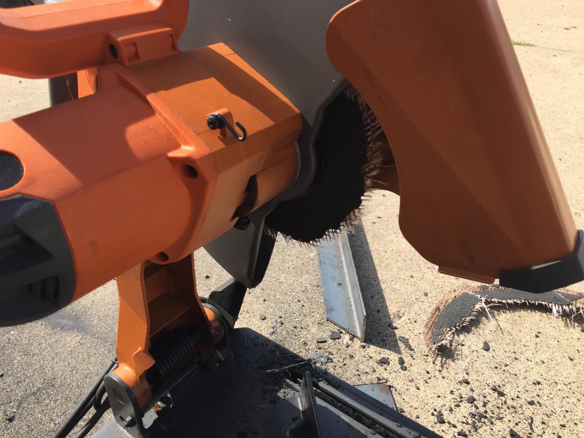

As some of you may recall, I purchased a Ridgid chop saw awhile back to speed up cutting bar stock and the like. Today I was cutting up some 2" angle (1/8" thick) for a drill press mounting base and being only the second occasion I've really used the saw for more than 1 or 2 cuts, it was still equipped with the factory cut off disc.
About 1/2 way through the second cut I heard a couple of clicks and before I could even let off BOOM! The damned thing exploded. In an unusual stroke of pure luck, only the smaller pieces peppered my while the larger chunks flew the opposite way. Could have just as easily been a bad situation.
The wheel wasn't overly worn (despite the small amount of shrapnel pictured) and I wasn't putting excessive force on it, it just kinda happened. Guess it's time for a new wheel :lol:

Glad you're ok.  Good thing you weren't one of those morons who runs bonded abrasives without a proper guard.
You may want to check the clamp because it looks like you're cutting at an angle and if the clamp is mucked up the workpiece can slip and bind the blade when you're cutting at an angle.
I've never seen a large blade shatter like that.  Can't even imagine how terrifying that would be.  Thankfully most places are replacing chop saws with the ones using carbide blades since the cut speed and finish is so much better.

I have the same ridgid saw, as this post an your other. Only problem I have is the screw thread holder clamp thing wore down. Can't clamp anything tight. Anyway I used the original disk till it wore down. It wore quick but no exploding. After worn I bought a diablo steel demon metal blade. There over 100 bucks but if used often there worth it. I hate abrasive chop saw disks.
I got prota bands bands(corded an cordless),metal cutting circular saw, grinders, plasma cutter, oxy-acetylene torch, an chop saw. They all work but if I could only have one tool for cutting I would use my portable bandsaw.
The corded and cordless non deep cut band saw is about the same price. I would probably go cordless just because I hate dealing with cords. Your also probably still within the 90 day return window at HD. Yes all fiber disks will explode, but that one definitely had something wrong with it to blow up after so few cuts.
